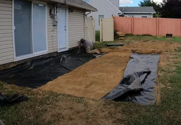

1. Determine the height from where your patio wants to be and start digging.
2. Lay down woven Geo Fabric, staple, and make it in place.

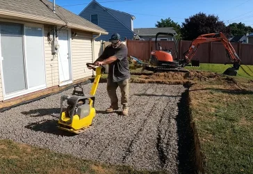

3. Put stones in three lifts, spread, and level with compaction in between, and end with compaction.
screenshot-2025-01-24-184349-webp.18

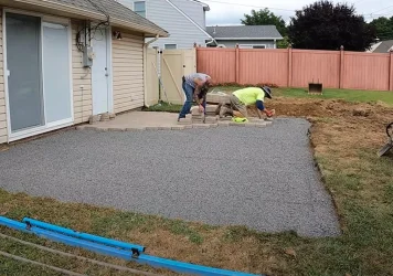

4. Place the pavers and make sure it laid evenly.

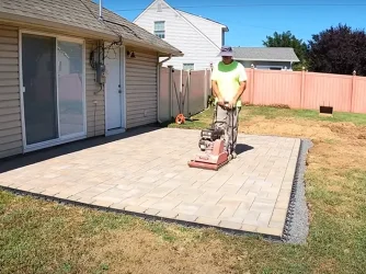

5. Put edging strips. Do compaction.

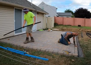

6. Brush in with poly sand with compaction in between to make sure all sand makes its way down to the bottom of the joint before you spray with water to activate it.
